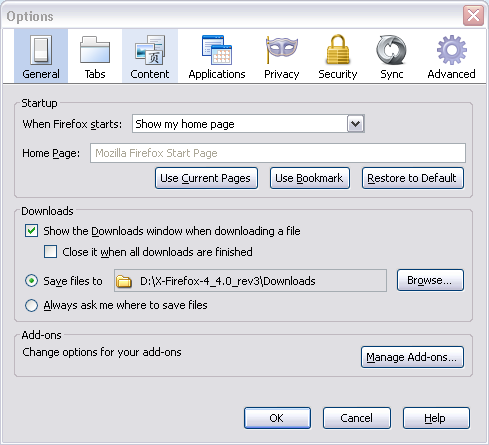

sab 30 apr 2011 - 01:58
nelson6e65 ha scritto ...
No. My problem persists. Now save the directory winPenPack\Downloads ". But when I put another folder In my case, it winPenPack\Downloads\Firefox and close and open the Firefox-4 is returned to winPenPack\Downloads. That is, I can not change.
As you have noticed, the download directory is set to winPenPack\Downloads. This was done for portability reasons.
When you start X-Firefox, from options it is shown:
To change the download directory you have two possibilities:
  1. to select "Always ask me where to save files":
  2. to modify X-Firefox-4.ini at the following lines.
    From:
    ;(download directory)
    browser.download.lastDir=$Download$|\\"
    browser.download.dir=$Download$|\\"
    To:
    browser.download.lastDir=FULL PATH OF YOUR DOWNLOAD FOLDER|\\"
    browser.download.dir=FULL PATH OF YOUR DOWNLOAD FOLDER|\\"
    Example:
    browser.download.lastDir=C:\Downloads|\\"
    browser.download.dir=C:\Downloads|\\"
