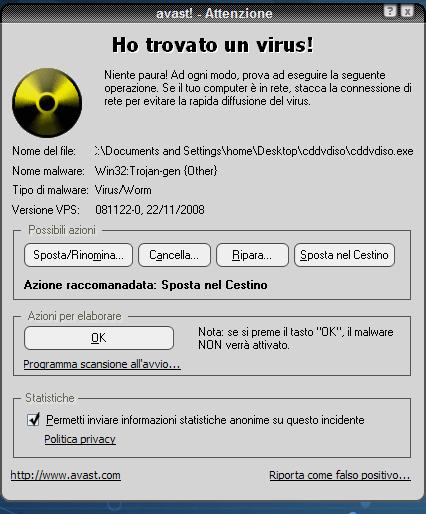

Sun 23 Nov 2008 - 17:53
CD DVD to ISO v1.0
Falso positivo?
