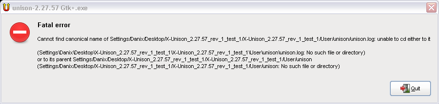

- Unison log file is created by default in the HOME directory. I have use the "-logfiles" directive to save it in the User\Unison folder to keep it separated from my Documents. This of course can be adapted to your personnal preference.
I think it is better to change it to:
Parameters=-logfile "$Home$\$AppName$\unison.log"
Otherwise, in paths with spaces an error is shown:
I update it in the next test relaese
